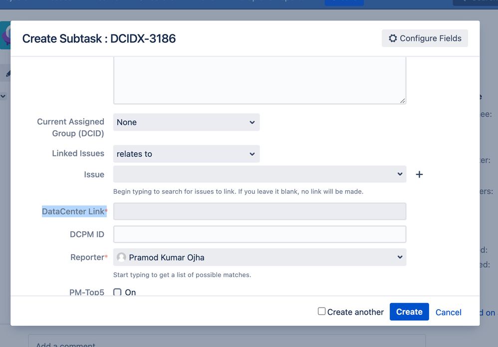

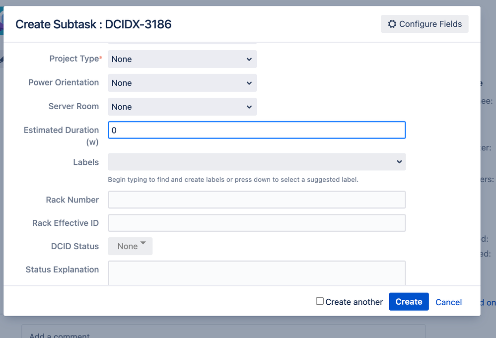

I am trying to set value to a field or trying to hide a field for my project but not working.
Pramod.Kumar.Ojha May 20, 2025
I am trying to set value to a field or trying to hide a field for my project using groovy script or by enabling readonly button in Behaviour. But not working.
Please help me to fix this.

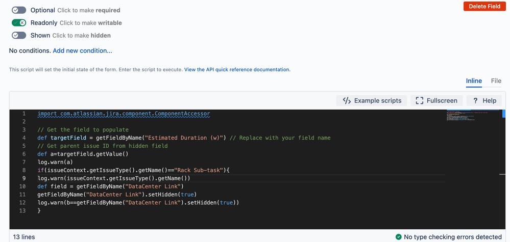

Hello @Pramod.Kumar.Ojha ,
You may not require the component accessor line here. Can you check with below script  based on your requirement - If type is Race Subtask then readonly to duration and dclink field as hidden.
def issueTypeField = getFieldById("issuetype")
def currentIssueType = issueTypeField.getValue()
// Fields to manipulate
def durationField = getFieldByName("Estimated Duration (w)")
def dcLinkField = getFieldByName("DataCenter Link")
if (currentIssueType == "Rack Sub-task") {
// Make duration field read-only
durationField.setReadOnly(true)
// Hide DataCenter Link field
dcLinkField.setHidden(true)
// Optionally set a default value
durationField.setFormValue("5")
} else {
// Reset to writable and visible if not "Rack Sub-task"
durationField.setReadOnly(false)
dcLinkField.setHidden(false)

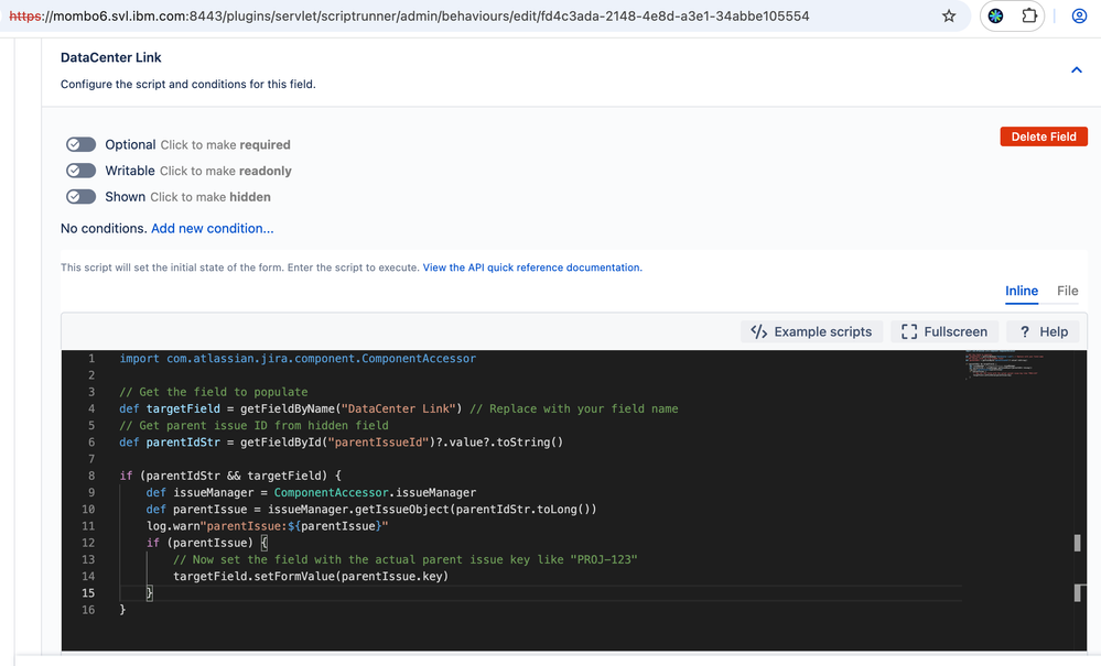

I already have working code which is working in Staging environment. But same code is not working in production.
// Get the field to populate
def targetField = getFieldByName("DataCenter Link") // Replace with your field name
// Get parent issue ID from hidden field
def parentIdStr = getFieldById("parentIssueId")?.value?.toString()
if (parentIdStr && targetField) {
def issueManager = ComponentAccessor.issueManager
def parentIssue = issueManager.getIssueObject(parentIdStr.toLong())
log.warn"parentIssue:${parentIssue}"
if (parentIssue) {
// Now set the field with the actual parent issue key like "PROJ-123"
targetField.setFormValue(parentIssue.key)

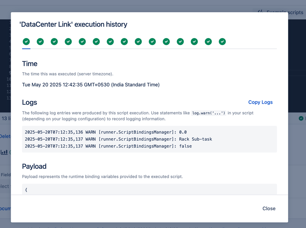

Any sort of error or something else you can share?
We are not getting any error.
I am able to set the field values of a different project on jira. But the issue is for specific project("IaaS DCPM"). Though we are not getting any error in behaviour but the value is not set on the field.
