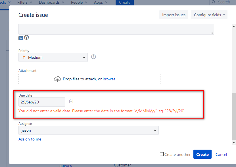

I try tı selecet the due date value. But when I select date and press create button. ı take below error.
You did not enter a valid date. Please enter the date in the format "d/MMM/yy", eg. "28/Eyl/20"

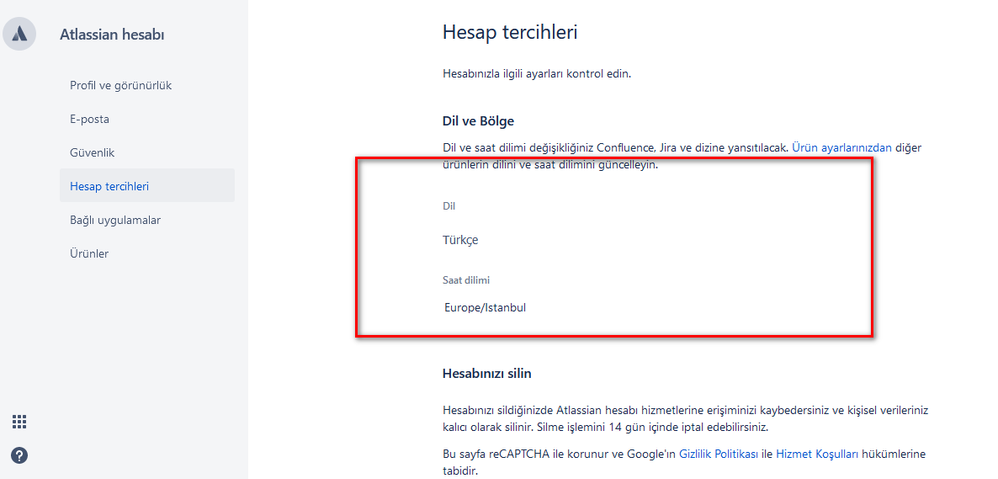

In that setup I was able to reproducethis once. But I found that waiting a few minutes and reloading the page creates a different result. It appears that when a user changes their language selection there, the corresponding Jira elements like date/time picker do get updated, but not on existing pages you might already loaded in your browser. Instead you need to refresh/reload that page after making a change like this in order to be able to see the correct date picker, like so:
In short, I believe there is an expectation that when a user changes their language/region preference within Atlassian Cloud, that they would need to refresh any open pages in order for those settings to take affect. Changing a language preference in Atlassian Cloud does take time for this preference to propigate itself down to all the different services in which your account might use an application that has language cusomizations of this nature.

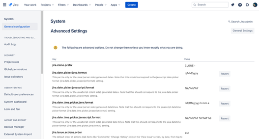

For example, I found that I could prevent this problem entirely, by adjusting the date input formats, and the picker formats to only use numbers when users enter date data (and not strings like 'Sep' or 'Eyl'). You could do this by going to Gear icon > System > General Configuration and then click the Advanced Settings button at the top of that page. On this page you can change
| jira.date.picker.java.format
This part is only for the Java (server side) generated dates. Note that this should correspond to the javascript date picker format (jira.date.picker.javascript.format) setting.
d/MM/yyyy | ||
This part is only for the JavaScript (client side) generated dates. Note that this should correspond to the java date picker format (jira.date.picker.java.format) setting.
%e/%m/%Y | ||
| jira.date.time.picker.java.format
This part is only for the Java (server side) generated datetimes. Note that this should correspond to the javascript datetime picker format (jira.date.time.picker.javascript.format) setting.
dd/MM/yyyy h:mm a | ||
This part is only for the JavaScript (client side) generated date times. Note that this should correspond to the java datetime picker format (jira.date.time.picker.java.format) setting.
%e/%m/%Y %I:%M %p |
or like so:
This change above both specifies 4 digit years (going from yy to yyyy for Java and %y to %Y for javascript), AND uses a 2 digit value for the month (going from MMM to MM in java and %b to %m for javascript). The previous values for months can still be displayed within Jira to look like 29/Sep/20 or 29/Eyl/20, those settings are controlled by the Look and Feel section of the user interface that Jira Admins can control.
But by changing these values in the advanced settings, the date picker no longer needs to rely upon the strings of month names that will commonly be different between user selected languages.
I hope this helps.
Andy

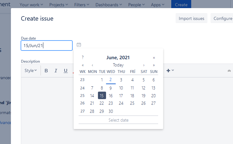

Unfortunately when I select the Turkish and reload the browser I get same error. When I change to english language I dont take this error.
As you see the calender is english. Calender dont change to Turkish like your screnshot.

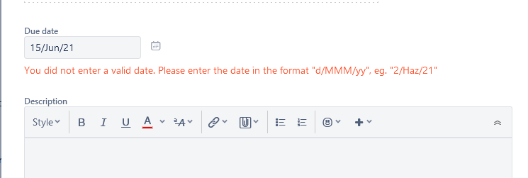

Hi @Süleyman
I think it has to do with the translation from English to Turkish(?). The example is showing the non-English version of the date, while the due date field is showing Sep instead.
Can you try whether changing Sep to Eyl manually gets rid of the error?
If so, I'd raise a bug request with Atlassian via support.atlassian.com/contact/
Kind regards
Jorden
Hi jorden,
Thanks for your reply.
as you said Jira dont give error if changed to Eyl and I could create it.
You can report this situation as bug.
