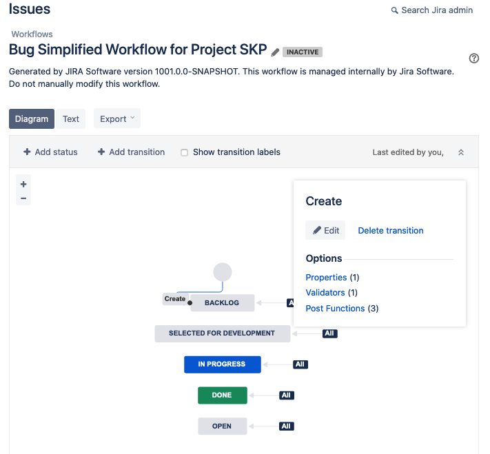

3. Once you click on Copy, it will open the workflow for you to edit. The workflow is inactive, so it won’t affect anything on your project or site.
4. Click on Diagram and then select the transition that you need the field to be required > Validators.

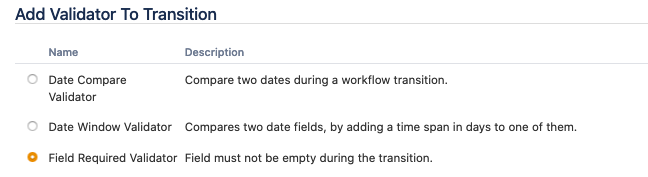

5. On this page, click on Add validator > Field Required Validator > Add.

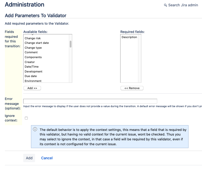

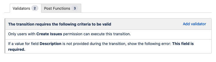

6. Then, select the field > Click on add > Add an error message (optional) and click on Add again.
Since it’s an inactive workflow, you can’t publish it, but the modifications are saved automatically.

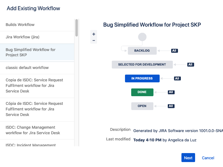

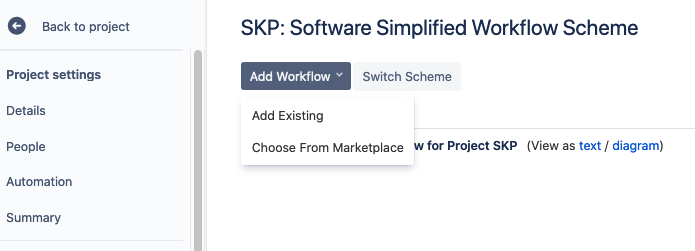

7. Now, go to Projects > Select the desired project > Project settings > Workflows > Add workflow > Add existing.
8. Select the workflow you previously copied > Next > Select the issue type Bug > Finish.
9. Once you do that, on the top of the page it will show the option to Publish, so click on it to save the changes and activate the new workflow > Associate > Acknowledge.

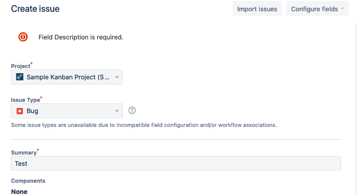

10. Now, when someone is creating a ticket, if they don’t add a value to the field, it will show the error message.
