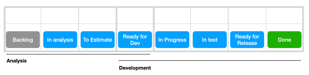

Hi @Amirhossein fathollahi madani ,
The scenario you describe is usually a process where part of the workflow (initial scoping and analysis) is done by e.g an analyst, PM or PO and then from a certain point in the process, those same issues are handed over to development through a status transition in the workflow.
That is perfectly possible with company managed projects as scrum and kanban boards there are in a way feature kits that are separate from your projects and issues. A filter defines the set of issues you want to show on your board and you map the statuses of your issue workflow to columns on a board.
That may look something like this:
Imagine that you are looking at an elaborate story workflow, where all the coloured boxes are the statuses your story goes through. From backlog to ready for dev, an analyst is in charge of the work. You could perfectly create an Analysis kanban board and map only these statuses to the columns of the board.
Ready for Dev is the final status of the kanban board. But it is at the same time the backlog status for the development team's scrum board. In that board you would fetch the same issues, but map the rightmost statuses to the column of your board.
Both boards can be based on the same JQL filter:
Project = ABC Order By Rank
This approach only works with company managed projects, because in a team managed project your board and the workflow statuses are exactly the same. You cannot add part of your workflow to a board in that type of projects. And I guess you will run into that problem in your current project soon, even though you can add an additional kanban board to your project for refinement.
