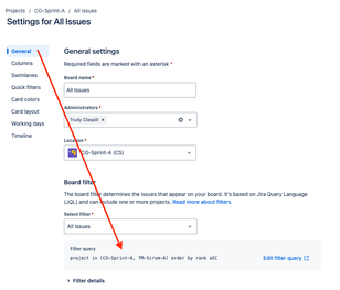

Hello @Greg Armstrong
What is the filter used by that board? To find that click on the ... button in the upper right corner above the View settings button and select Configure board
Select the General tab and tell us what it says in the filter query area.
It is possible that the query has been changed such that the issues are all being hidden from view.

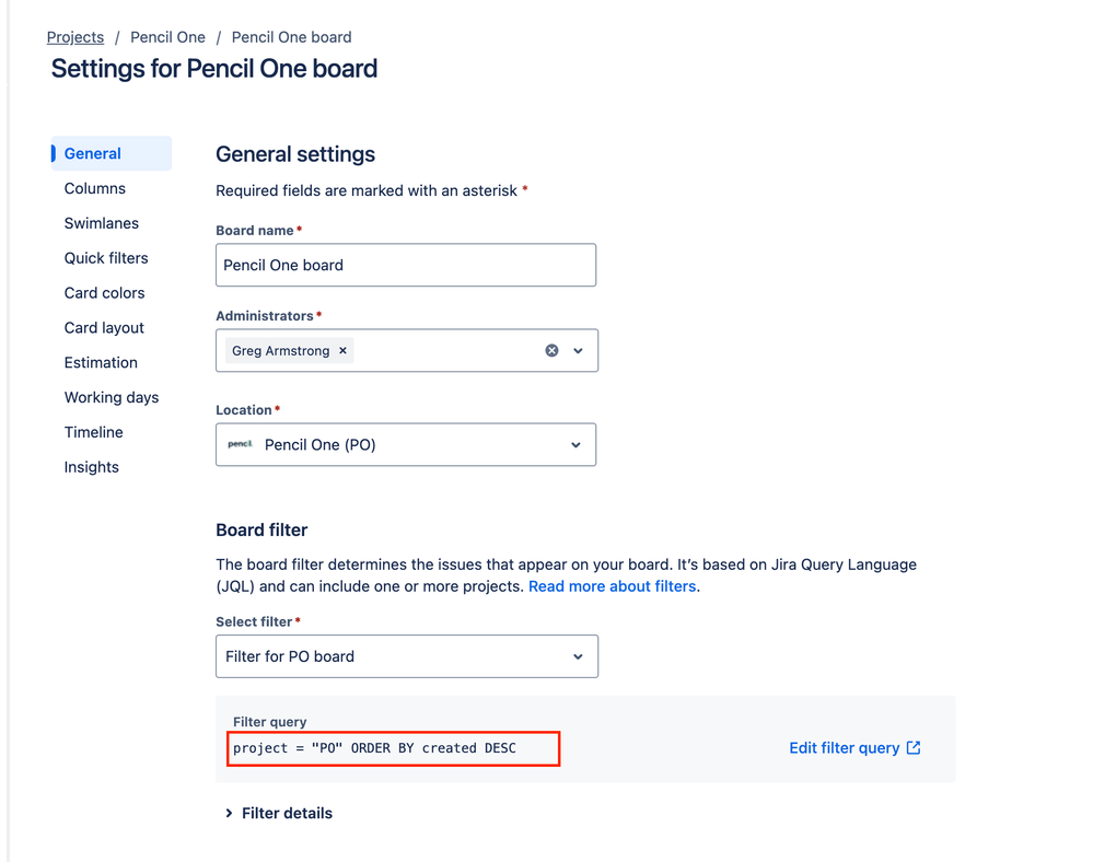

Hi @Trudy Claspill ,
Thanks for following up.
The settings are as per the attached screenshot.
Should I update "project = "PO" ORDER BY created "DESC" to project = (PO) ORDER BY created DESC"?

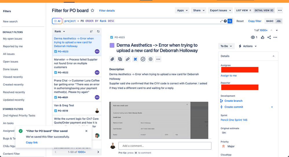

Another note is we cannot find anywhere to reindex our Jira instance. All the guides we found are incorrect. Is it possible to reindex?
We tried changing the filter to the following:
project = "PO" ORDER BY created DESC
project = "PO" ORDER BY created aSC
project = "Pencil One" order by rank aSC
project = "PO" order by rank aSC
project = PO ORDER BY Rank DESC
All return results except for the one (PO).
Could this be a reindexing issue that we cannot resolve ourselves?
This issue is killing us as we mange projects from 4 different countries/locations and now we have no easy way to know where all our tasks are at.
Any help in solving this is greatly appreciated.
Greg

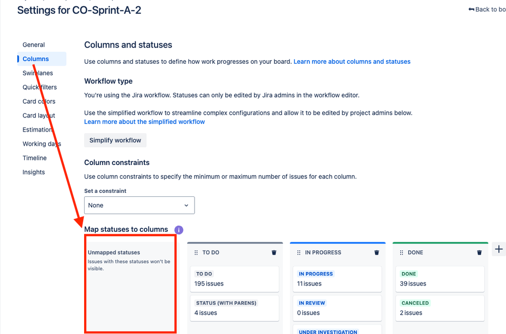

Re-indexing happens automatically in the Cloud as needed. If a re-index does need to be forced, your Jira Admins would need to contact Atlassian Support directly for that.
I don't see anything wrong with your original filter. Do note that since you have/had the ORDER BY clause set to "created" (rather than rank) you would not be able to drag-and-drop the issues to reorder them in the backlog or board.
Please check the Columns/Status mapping configuration for the board and make sure that all statuses are mapped to columns and none of the statuses are in the Unmapped Statuses area. Issues in the statuses that are in the Unmapped Statuses area will not be visible in the board or backlog.

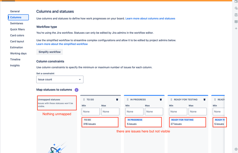

I am the Jira admin, I will figure out how to contact them to see if they can reindex for me.
Regarding the columns, we have used this board for 6 and half years now and mapped all the columns then. I've attached a screenshot of the view. Interestingly it shows there are Jira issues in each column, just not visible in the Backlog.
Any other suggestions?🙏
Greg

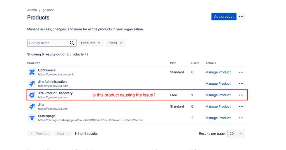

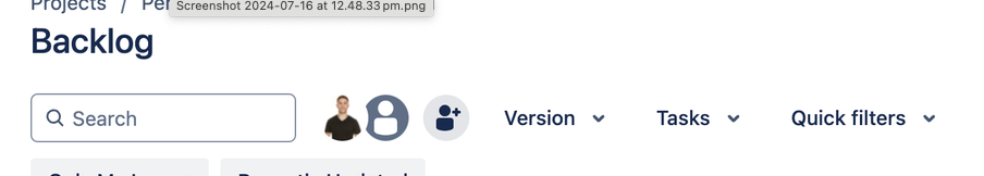

A couple of other things.
The first is all the users except for the person who is logged in have disappeared from the backlog. See attached screenshot for reference.
Secondly, when I view our Products, there is "Jira Product Discovery" with one user (me). Could this be causing the issue?
Greg
Hello Greg,
This is a puzzler.
You can contact Atlassian support by opening a case at https://support.atlassian.com/contact/#/
I don't think that the Jira Product Discovery product would cause this problem, but I don't work with that product so I can't be certain.
The Assignee avatars should display the logged in user and avatars for any user that is assigned to a visible issue.
Can you pull down each of the filtering buttons at the top of the screen and confirm that no filters are selected?
I ask because where yours says "Tasks" mine says "Type". I'm curious if you are filtering by the Task issue type, and/or what options are available for that pull-down.
Do you have more than 5000 issues in this project? If so, have you just recently gone over that 5k number? Boards are limited to display no more than 5000 issues, but it should actually display those issue and give you a warning to that affect, but that doesn't seem to be the case for you.
Just for giggles can you try creating a new board from the same filter and see if that nets a different result?
