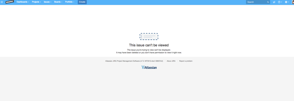

I had a problem with some issues - they all belong to the same project.
When I am opening a link to the issue I am getting a page "Issue cannot be viewed".
I am sure that this issue has not been deleted, they disappear after I changed the workflow of the particular project.

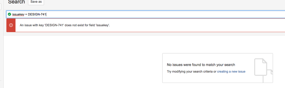

The issue also cannot be seen in the Issue Navigator (Issue search).

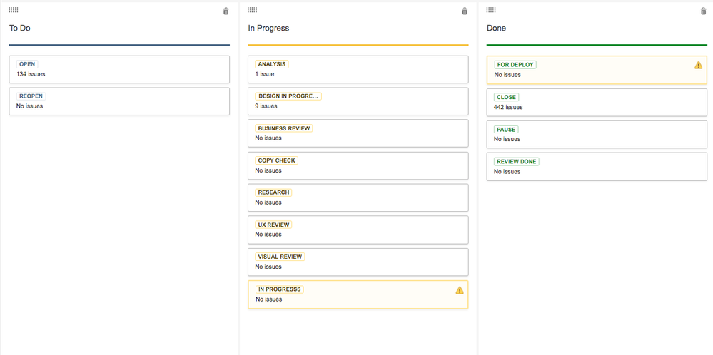

I mapped all the statues in Board Configuration Columns (see the attachments).

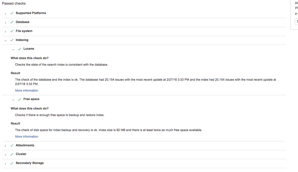

I've reindexed the particular project and all issues in Jira.

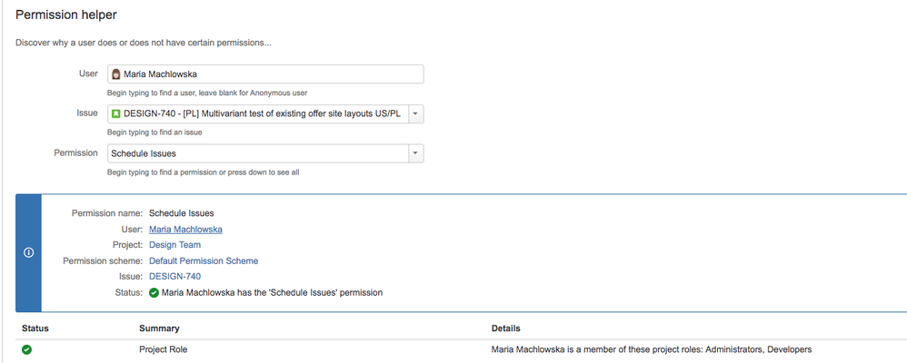

Do you have full permission to see the project? (Admin gives you admin rights, not project rights). Does it have a security scheme?

If it is the whole project, then check the permissions for the project and check you have access. As I said before, your admin rights are irrelevant, you need project permissions, and they are separate (admin rights mean you can always edit the permissions and people in a project though)

Working with your screenshot which shows you looking for DESIGN-741, first, read the table project - look for the pkey of DESIGN, and get the ID for that row.
Second, read jiraissue. You need the ID from above for the project column, and then the issuenum is the number of the issue - 741 .
If there is an issue there, then the problem is permissions. If there is nothing there, then the issue has been moved to another project (to which you don't have permissions) or it has been deleted.

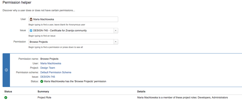

I cannot provide the proof of the issue that disappear, because it doesn't exist in the navigator anymore, but I can provide the permission helper for another issue from tthis project:

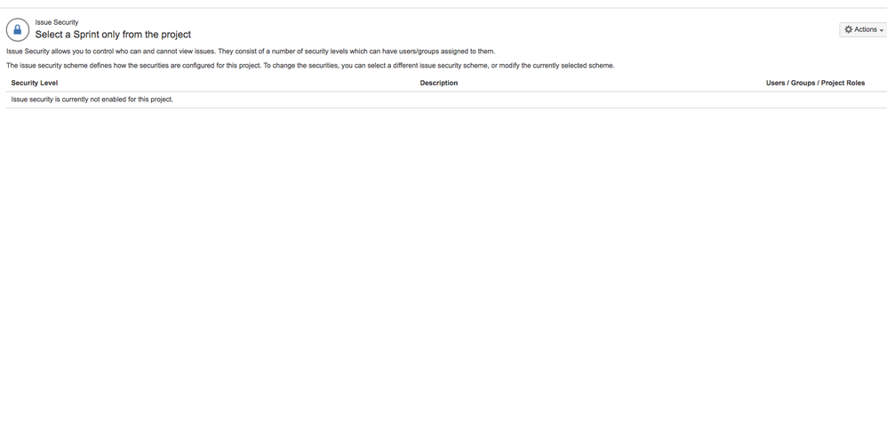

Does the project have security scheme?
No, it does not. I have no such option in my instance in Jira:
Project Details:
Jira Administrator Seetings Menu:
Only Security I found is in Project configurations and it's called "Issue Security". But it has nothing specified.
