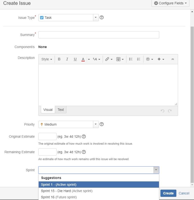

We have sprint 1 and our current sprint showing as active. We don't have parrallel sprints marked as active. How can we disable, or prevent sprint 1 from showing as active from the drop down list "sprints" when we create a new Jira ticket?

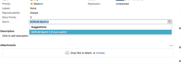

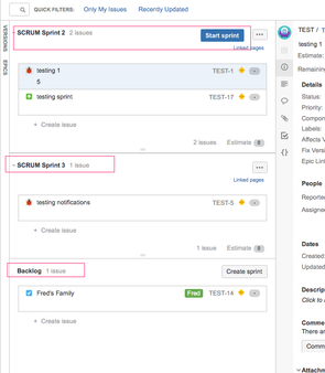

So I'm puzzled by this for sure. If indeed the sprint is "complete". What should be the case is that the Sprint field should only display options for sprints that are not "Complete". This includes "Active", "Future" and the upcoming. As you can see in the image below I have the next sprint ready to go and the test issue is set to it. I can select a "Future" sprint as well but not any completed sprints. Note I am on cloud and unsure if you are cloud or server.
What does your backlog show in the way of sprints? Can you provide an image of exactly what you are seeing. Depending on your feedback here I may reach out to other experts to chime in here.
sprint.pngAnd here is a view of my backlog...

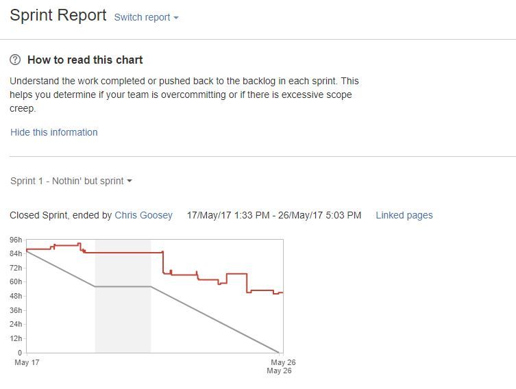

I attach images of what I am seeing:-
Firstly Boards->Scrum->Reports->Sprint Report
JIRA3.jpgThen The Create Issue screen:-

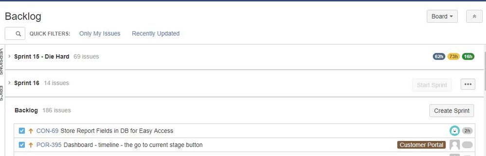

JIRA1.jpgAnd finally the backlog screen:-

It turns out the sprint I had completed and the sprint showing up in the available sprints were almost, but not exactly, the same. It looks to be the same above, where there is a "Sprint 1" and a "Sprint 1 - Nothin' but sprint". These are two different sprints. Once I added an issue to my equivalent of "Sprint 1" as described in the link above, I was able to delete the phantom "Sprint 1".

Within "Create Issue" it shows as an active sprint.

If I go to "Boards->Scrum->Reports->Sprint Report" Sprint 1 shows as closed. Yet it is selectable from the "Create Issue" screen. Can you suggest why this might be?

I'm not sure how to tell if the sprints are part of the same project. I can tell you that they appear in the "sprint" menu when creating a new Jira ticket.  I checked in the backlog and found 2 sprints there. However the sprints that were there were sprints 15 & 16. The two sprints that appear in the drop down list in the create screen are sprints 16 & sprint 1.
