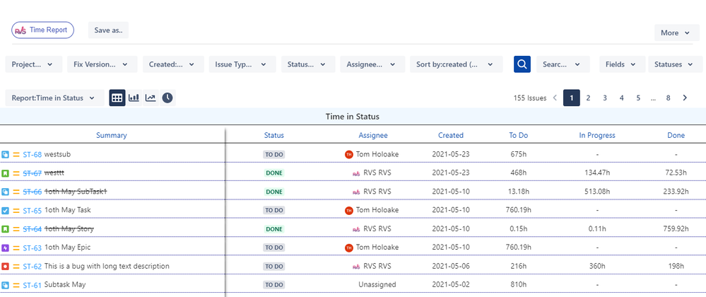

If you would be interested in a third party app to group your statues and view count for each of your status groups, you can try out our app
Time in Status Reports
The add-on provides the time in each status for the entire lifecycle of the issue and you can filter by issue type as well. You can also combine your statuses to define your lead/cycle/resolution time and also extract the transitions history of the issues. The main features of the app are as below
  • More than 8 types of Time in Status Reports. Excel Export available for all status reports.
    • Time in Status
    • Time with Assignee
    • Time in Status with Assignee
    • Time with Assignee per Status
    • Status/Assignee Count
    • Multiple Transition Reports
    • Avg Time in status reports
  • Status grouping
  • Save your reports
  • CSV Export
  • Multiple chart types
