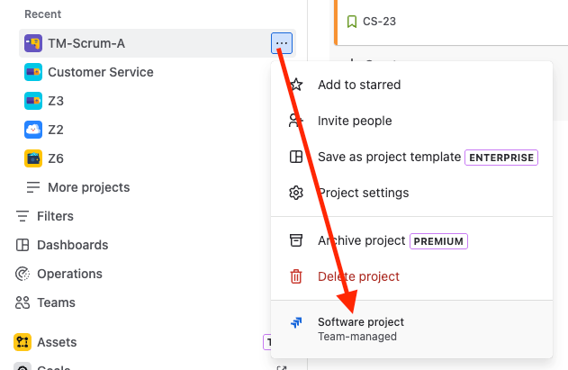

Hello @Tony Parkes MOD
What are the project type of the source project and the destination project? Get that information by clicking the ... button next to each project's name in the panel on the left.
If the source is a Team Managed project, were the fields created a local custom fields in that specific project, or were you reusing Global custom fields?
What are the types of fields missing data? Text fields? List fields? User fields?
Did you map just the field names, or did you drill into mapping the specific field values?
