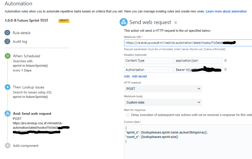

@Bill Sheboy ,
I've only done one other REST automation. Does this look correct? I couldn't print the names of unique sprints to the log file, so I gave up on that. I'm assuming there will be another incoming web part to this.
Bill Sheboy
September 30, 2024
I was answering the question you originally asked.  You would need to review the interface to that call to know if it is correct based on what you are sending.
From what I can observe...
That rule uses a scheduled trigger with JQL.  That means it will repeatedly make that call with Send Web Request.  Is that what you wanted to do?
As written using the Lookup Issues action, this will only find future sprints for which there are issues assigned.  Is that what you wanted?
Finally, Lookup Issues returns a list of issues, and the Sprint field is a list of values.  And so your count_n parameter is a list of counts (e.g., 0,3,1,4...) and not a single count of the distinct sprints.  Again, I recommend checking what you want to send in that call and adjusting, as needed.

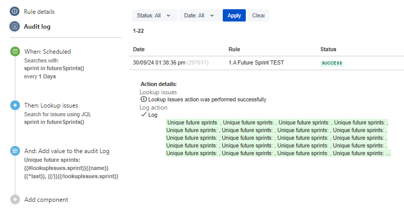

Tom Scoggin
September 30, 2024
@Shawn Doyle - ReleaseTEAM
Currently I'm just trying to get a list of the futureSprints() to print to the LOG.Capture.PNG

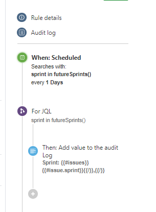

This is my last try. It's getting the 73 correct records but not printing the sprint name.
