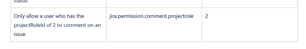

I found this in the documentation:
Use workflow properties
I'm trying to limit by project role who can edit the issue. It appears I need to know the Project Role ID to do this. Where is that found?
It is this part that is my problem. I understand I should have jira.permission.edit.projectrole for the property but I don't know where to find the ID # (2 in the example) for my project. I assume it is added at the end either as a tag on projectrole2 or as projectrole.2 or something that works.

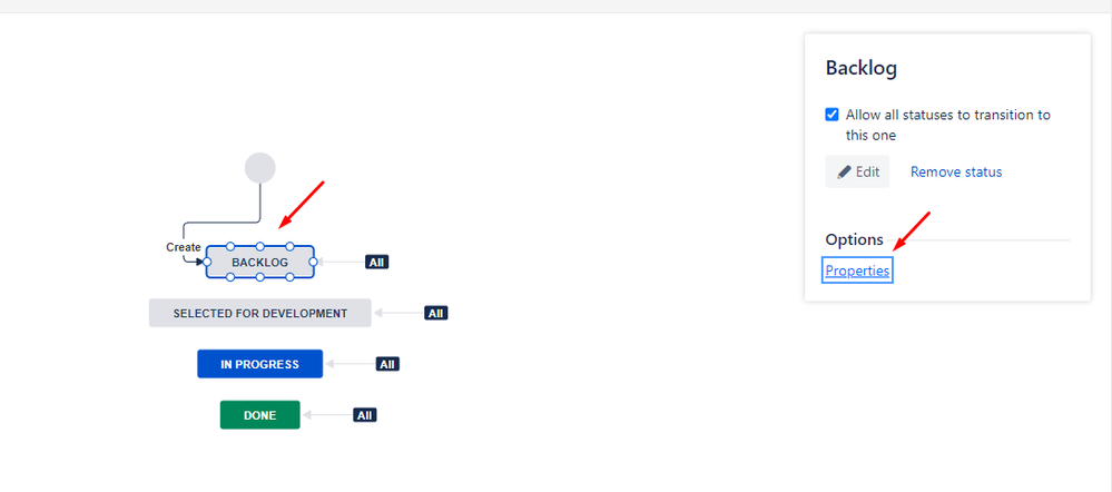

In Roles list, in System, press Edit, or just hover mouse over this button, and you will see ID of Role.

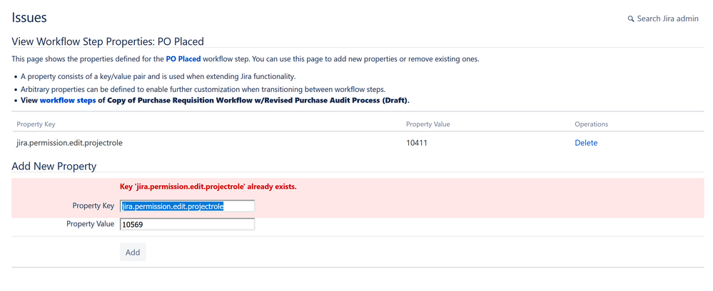

Danno
August 14, 2023
@Evgenii Nope, that seems to be a problem with this particular permission. It doesn't work the same as specifying multiple users. I was hoping I could just list them all in the one property but I guess it isn't possible either. See below:
Evgenii
August 14, 2023
Hi, @Danno
I meant, that you must add numbers to properties, at the end, after dot(.)
It can help to add multiple similar properties. I made an example:
