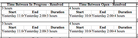

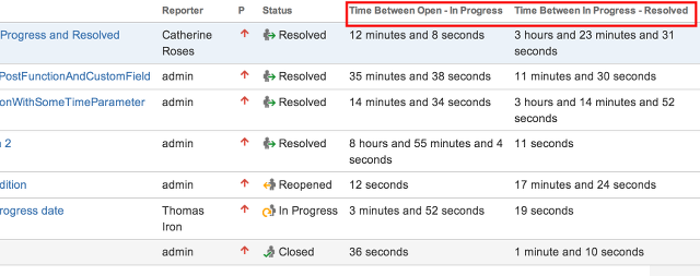

You can also measure how much time a developer spent on an issue until it's resolved and how much time spent in each status using Enhancer Plugin for Jira .
Enhancer plugin has a custom field called Time Between field that shows the duration between statuses and dates that you specified. You can add this field to issue search to get detailed reports on each developer by exporting a search result.

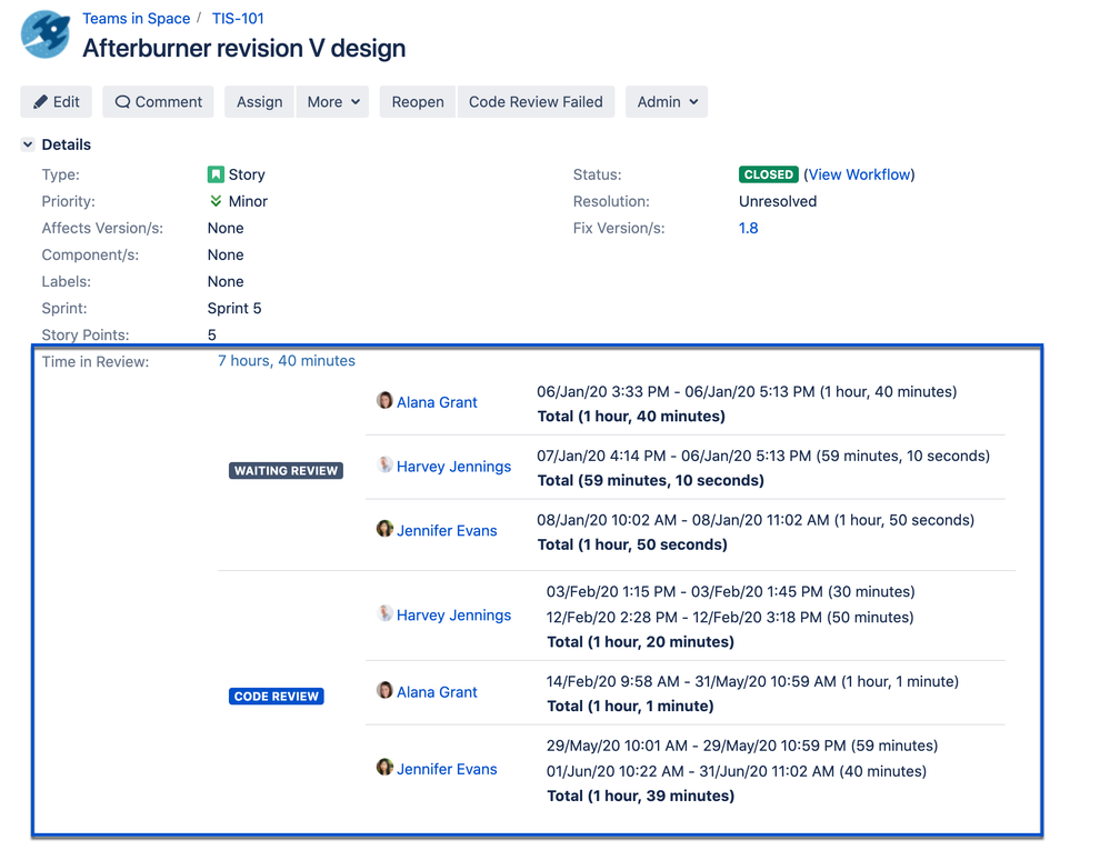

It also has other custom fields that can help you with reporting and measuring Time spent on tasks such as Time in status which calculates the time spent in each status by assignee so that your manager can analyze the work done by developers better:
Let me know if you have any questions.
