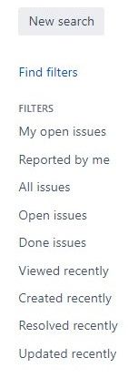

I may not be the assignee or reporter on it. I just probably viewed it but not necessarily commented on it.
There are these default filters provided by Atlassian. I was trying to leverage the 'Viewed Recently' filter but I don't know what should my search field be to indicate searching by current user?
note this will be limited to the last 50 viewed issues. you can add the last viewed column to sort the list by that if desired.
I realized that the default filter can be used for my purpose here. Thanks though for helping. It makes sense. Issue in issueHistory() and sort by last viewed
Thanks Pramodh and Jack.
