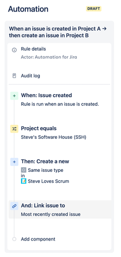

To properly create a linked issue via automation, you can use a rule like this (sample from the template library):

Hi @nasiruddin.nordin , welcome to the community and thanks for your question.
I would suggest you check the Automation library.
Here is a rule I think could help you - Jira automation template library | Atlassian
Basically, you will need a rule that has multiple projects in its scope, so you will either need to have access to the Global automation section of the Jira system settings or get someone to help you with this.
