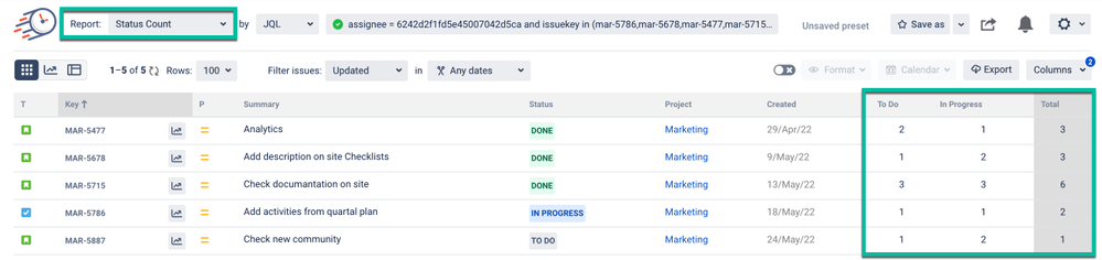

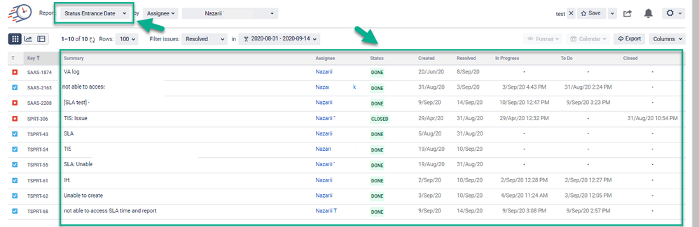

I can recommend you to try Time in Status for Jira Cloud and its Status Count and Status Entrance Date reports.
A Status Entrance Date report shows the date when the issue has entered the status for the first time.
A Status Count report shows how many times an issue has moved to each status.
