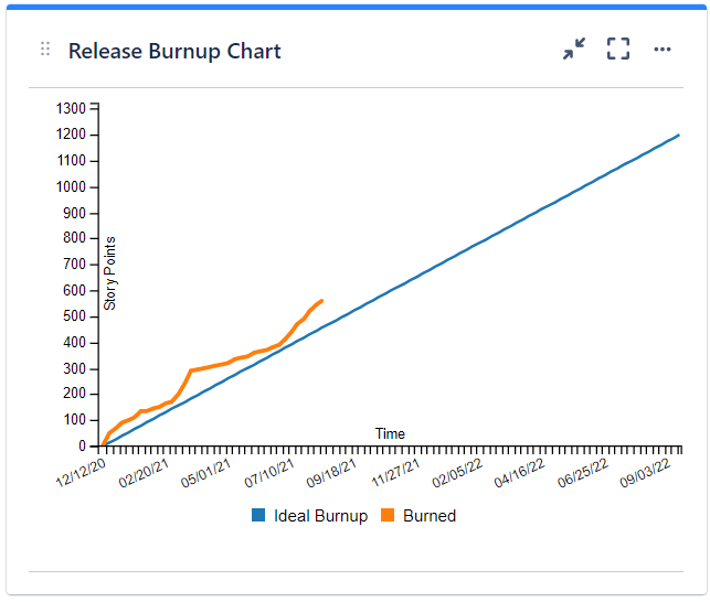

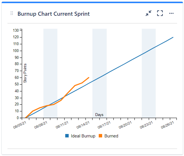

Hi @delaram nezami,
Try the burnup charts offered by our Great Gadgets app. They are highly configurable and do not use the resolution field but the issue status.
If you need any help, please contact support@stonikbyte.com
