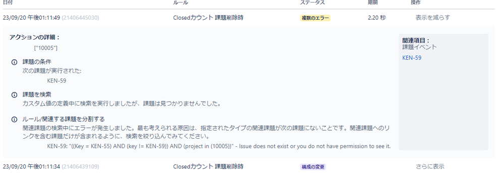

Using the deleted issue trigger will result in the following error.
Split rules/related issues
An error occurred while searching for related issues. The most likely cause is that the next issue does not have a related issue of the specified type. Try narrowing your search to include only issues that contain links to related issues.
KEN-59: "((Key = KEN-55) AND (key != KEN-59)) AND (project in (10005))" - Issue does not exist or you do not have permission to see it.。

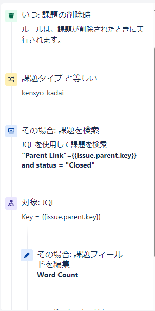

When I use the issue deletion trigger, I get an error in the Then: Lookup issues part because the issue has been deleted.
First, the "Parent link" field has been deprecated, so please consider no longer using that. Please look here to learn more: https://support.atlassian.com/jira-software-cloud/docs/upcoming-changes-epic-link-replaced-with-parent/#Updates-to-automation
Next, when the Issue Deleted trigger fires, the issue is captured for use in the rule. And so the fields are present. I just tested this to re-confirm the behavior in Jira Cloud.
