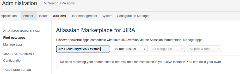

1. As I am searching in search box "Jira Cloud Migration Assistant".. but no apps are coming

Take a look at this documentation https://confluence.atlassian.com/upm/installing-marketplace-apps-273875715.html
But it probably won't accept your version of Jira. You're going to have to upgrade it to a newer version. Because Server was EOL'd, you may have to make it a Data Center instance by installing a trial Data Center license, upgrading the version of Jira, and migrating to cloud. You should probably set up a plan first.
