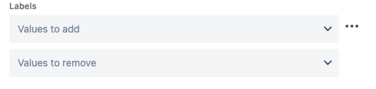

Did you use the add/remove value option on the Labels in Automation? If you click the three dot menu you should see that option:
But yes, this is a workaround and you may run into situations where it may fail, so updating the process is probably the easiest.
