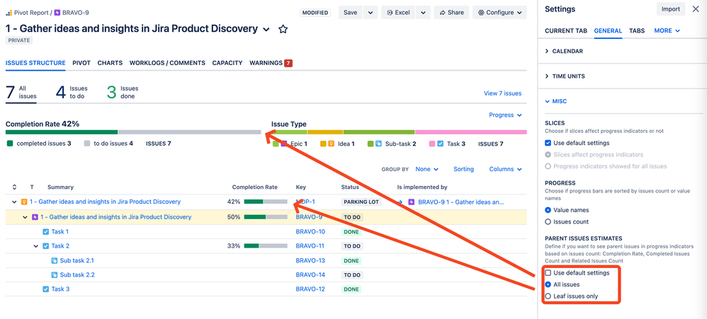

There's another approach to this: you can use 3rd party apps that can report on linked issues. Delivery tickets are connected to JDP issues via "is implemented" issue link. Therefore you can use an app that will take your source JDP issue(s) extend it with linked delivery tickets. I know that as a vendor of Pivot Report. I did quite a few demos for our customers on that:
Please note that you can choose how the progress is calculated: based on all issues or just "leaf" one. In the example above Completion Rate is 75%, though only 3 issues out of total 7 are complete. But in reality source JDP idea, Epic and Task 2 are only "containers" for the actual tasks and sub-tasks.
If you switch it to All issues, the result will be different:
This is something you need to take into consideration when you create automation rules as well. Not every issue worth to be counted as a part of the overall progress.
It worth mentioning that Pivot Report does all types of progress, pivot tables, charts, etc. You check the screenshot below or play around with demo reports on your own:
Pivot Report can be used as a stand alone report, dashboard widget(s) and gadget right in the Issue View. Embedding to Confluence and downloading a static snapshot is also there.

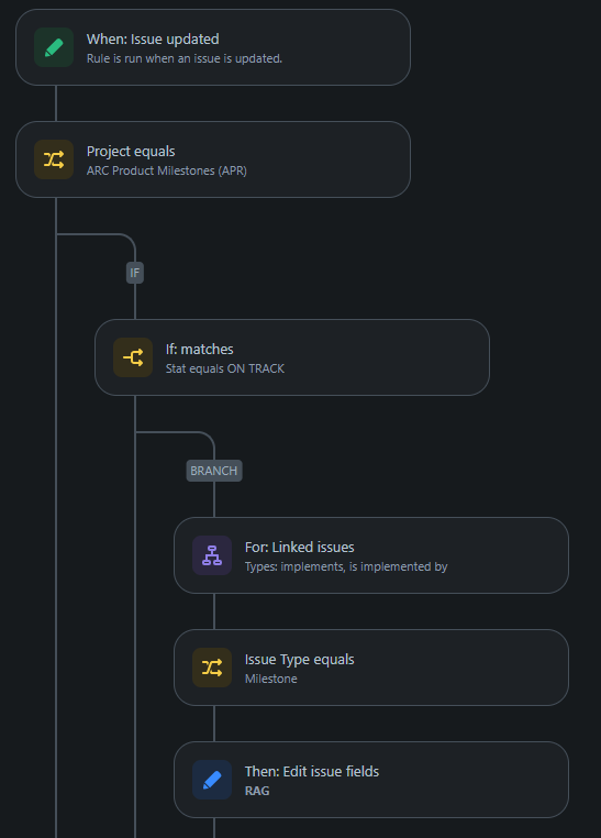

I do precisely this on a few different fields in my JPD Ideas that are linked to delivery tickets. In my setup, I have a JPD Idea that is linked to a Initiative in my Product Jira project. The Initiative is what is used to plan all of the activities in Jira using advanced roadmaps and in my case it is a parent to the Epic in my issue hierarchy, This is important to point out as I also link (via automation) any epics as delivery tickets for the JPD idea associated with my initiative so that I get an accurate Delivery Status in JPD.
Enough of the caveats. Here is my rule logic:
My rule is limited to only run when a certain field that I want to keep in synch is updated in a certain project. I am using this to synchronize a product Status field that I use in Dashboards and filters to depict the status of the initiative. This status is set manually by myself ahead of the stakeholder update meeting so that I can call out any risks or conflicts which pertain to the initiative as a whole as opposed to a single delivery ticket.
The rest of the rule is just a bunch of ELSE-IF statements for each of the possible values. This only gets triggered when the field is updated in the JPD project and will only update Milestone issue type that are found via the Linked Issues Branch.
Hope this helps.

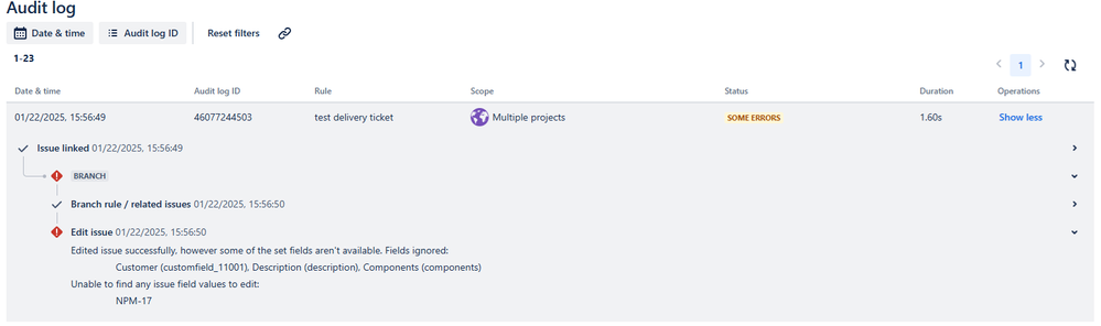

Thanks that did help, particularly the link type, which wasn't immediately obvious. My issue now is that Description in PD isn't recognized as the same field as description in Jira. I need to set up global fields in PD so that when I specify Description field in PD it is copied to description field in Jira.
