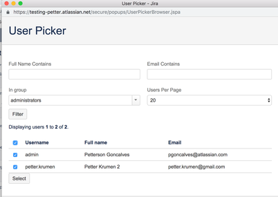

I believe that the only way that you can do this kind of configuration would be by adding a user picker (Multiple Users) custom field that must be filled in the creation of the issue, so you will be able to filter your gadget with the following JQL:
"user picker custom field" = currentUser()
Performing the steps above, your gadget will only display the issues where the current user is one of the users added to the Custom field.
Also, the user picker (Multiple Users) custom field can be filled with an entire group, so you will not need to flag every single user everytime you create a new ticket:
Please, let me know if this option would work for you, Simon.
