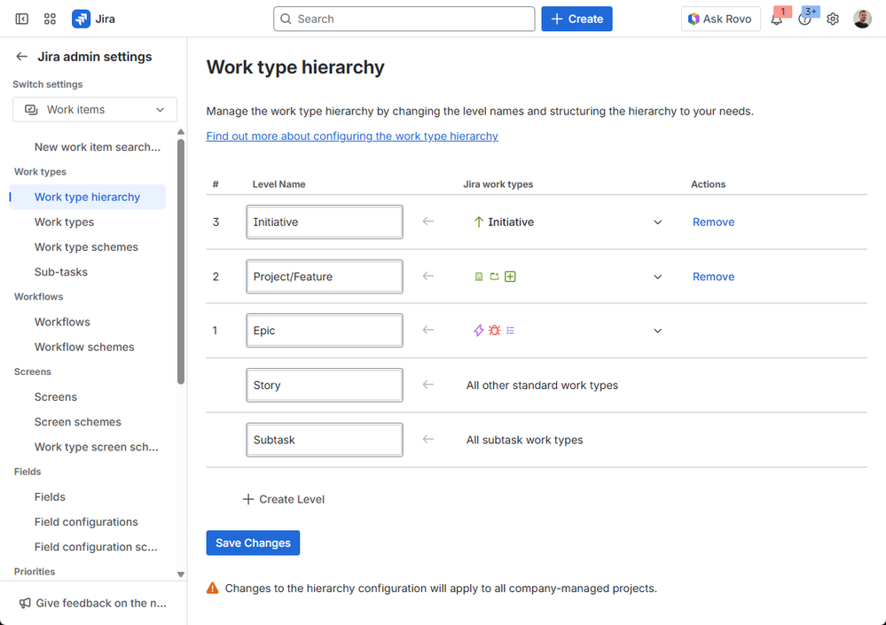

Also, a good question is why the current config. is 'wrong'? Looking at some Atlassian recommendations, this structure is fine. Even demo Atlassian sites have it configured this way:
Level Level name Jira work types
3 Initiative Initiative
2 Project/Feature
Campaign
Project
Feature
1 Epic
Epic
Risk
Deliverable
0 Story
-1 Subtask
⚠️ Note that you cannot move Epic from level 1; you could rename the default Epic and then use a custom one on levels above/below, but I wouldn't say that's recommended.
