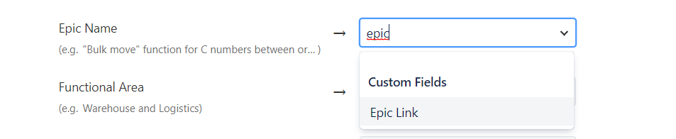

Isabel Kaiser October 11, 2021
How can I import the Epics from CSV and then provide the names later? When I use the import tool, I cannot match the field "Epic name" although it is a column in my csv.

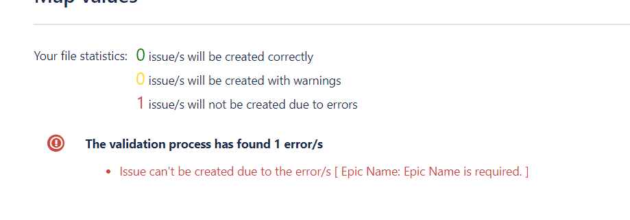

But I cannot import the epic without the epic name field:
Does anyone know what I am doing wrong here?
I have tried the work-around of importing the epics as stories and then bulk moving them to epics, but when I do this, I end up having the same Epic name for all of the epics instead of having individual names per epic.
Thank you!

Hi @Isabel Kaiser ,
Do you have the 'Epic Name' field added to your screenscheme?
Are you using the (admin) import? Accessible via: Settings -> System -> External System Import
/Melle
Like # people like this
Isabel Kaiser October 27, 2021
HI @Melle van Keulen
I didn't use the admin import before. I now tried it the way you described it and it worked.
Thanks for the advice!
