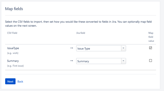

My CSV contains IssueType and this works successfully when importing via the admin approach but using the standard user method it does not. When you map IssueType only the fields visible on the create screen are selectable which does not include IssueType. In the admin mode the issueType is available to select. The documentation link attached does not distinguish between the modes.
I am very willing to believe I am doing something wrong but to me it does look like a major drawback with this approach.
Viewing the example data I presented you in the answer above I went to a Jira Server instance where I am definitely not admin and got a positive result. (Jira version 8.3.4)
Note: by purpose I did not select the standard value "bug" but a more rare one.
So the Issue Type is to be mapped (on the following page the Issue Type even could be selected so I went for an even more special one) - and the import worked out. Do you see the same information when trying to import or how does it present the window to you (as user, not admin)?

Thanks for this, it was user error. The issues I had created did not have Issue Type on the create screen. This has fixed the problem. Thanks for your patience.
