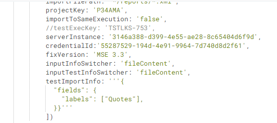

Hello @Stefan Salzl ,
Thank you very much for your answer. xray-connector is a plugin for Jenkins, that allows Jenkins to integrate an XML with Jira/Xray :
https://www.jenkins.io/doc/pipeline/steps/xray-connector/
In my pipeline I have a step in which I integrate an XML test report with Jira/Xray.
This XML is successfully integrated, and creates a Jira Test Execution, but unfortunately no labels are associated to this Test Execution.
step([$class: 'XrayImportBuilder',
//endpointName: '/nunit/multipart',
//endpointName: '/junit/multipart',
endpointName: '/junit',
importFilePath: '*/reports/*.xml',
projectKey: 'P34AMA',
importToSameExecution: 'false',
//testExecKey: 'TSTLKS-753',
serverInstance: '3146a388-d399-4e55-ae28-8c65404d6f9d',
credentialId:'55287529-194d-4e91-9964-7d740d8d2f61',
fixVersion: 'MSE 3.3',
inputInfoSwitcher: 'fileContent',
inputTestInfoSwitcher: 'fileContent',
testImportInfo: '''{
"fields": {
"labels": ["Quotes"],
hi @Cláudia Sofia Martins da Silva
according to the documentation I can‘t see any information that fields could be set via
"fields": {}
The documentation says this parameter expects a string (even not saying what this parameter would set).
Any further information where this is described/that it is possible?
Furthermore I guess this plugin will then also call the rest api. As the xray api can handle xray specific tasks I can‘t imagine this is possible at all as setting a field is a Jira native action and would need to call the Jira Rest API as well.
