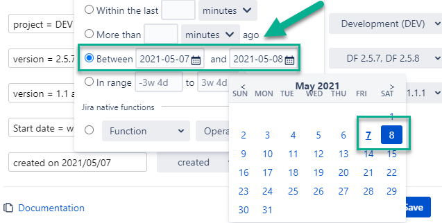

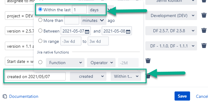

The other option I can recommend is the Dynamic Filters: JQL Replacer add-on. It allows you to set queries without JQL knowledge.
For your query, you can choose created within thee last 1 day as shown below:
Or set the dates you need from the drop-down calendar:
Hope you find this info helpful.
