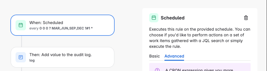

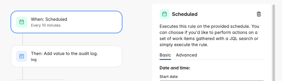

Are you referring to the Next Run information that shows when you look at the Basic tab of the Scheduled trigger configuration? I believe that information is being shown based on the Basic settings that are selected, not based on the Cron specified in the Advanced tab.
You may notice that the Scheduled trigger in the flow on the left shows the schedule based on which tab you have selected:
Screenshot 2025-07-11 at 12.19.23 PM.pngScreenshot 2025-07-11 at 12.19.32 PM.png
You need to save/publish the rule with the Advanced tab selected in order for the Cron to be used as the rule schedule.
And there is no display in the Advanced tab of the next run time.
