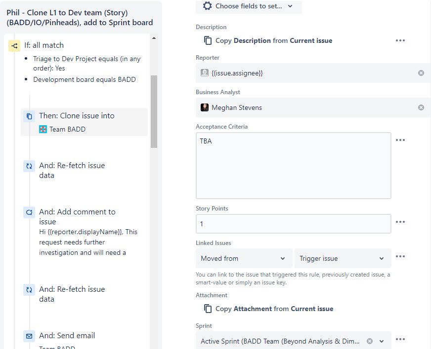

I'm trying to fulfill a somewhat odd request to populate a newly created column in a sprint board with only issues cloned in an automation from a JSM issue to a Jira software issue.
(An alternative might be to assign a unique priority to the created issue in the clone automation, or create a single selection field and in the clone automation, select a value for it, and sort the sprint board by Priority or by the new field. I haven't succeeded in sorting the Sprint board by Priority. When I click the sort arrow, thereby changing Order by Rank ASC to Order by Rank DESC, the To Do column is still sorted by issue key Ascending.)
So back to the new column: I created a new Status in the Jira software workflow used by the created issue cloned from the JSM issue, but I'm struggling to figure out a way to use a branch or other technique in the clone automation to transition the created issue to new new Status, that would populate the new sprint board column. Can you help with that, please?

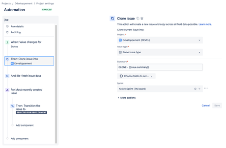

It's possible to show your current rule ?
Alternatively, perhaps you can try filling in the sprint field in your first automation rule, wait for Jira to create the new ticket correctly and then perform the status transition?
If I misunderstood your need, let me know.
For your second rule, you can identify some of the same fields (summary, description, reporter, etc.) between your two tickets or maybe if you have the link in "Linked Questions", you can retrieve it through this field.

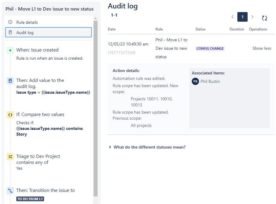

The clone automation already sets the sprint. When I changed the new automation that's triggered by issue creation from All projects to 3 selected projects, it doesn't execute. When it was global, the issue that triggered it was the "parent" issue (the issue that cloned the new issue). How can I either insert an action to transition the new (cloned) issue, or get the new automation to detect only the new (cloned) issue?
Clone automation
New automation
Actually, I thought there ought to be an action to trigger a rule from a rule, but I didn't see any. I'll try this.
Since {{createdissue}} works in an email action in the clone automation, shouldn't it be possible for me to transition the new issue right from the clone automation by referencing the created (cloned) issue?

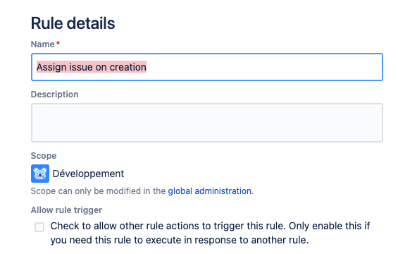

I've checked the "allow rule" option. Do I need to specify the clone rule someplace in the created issue rule? Add something to the clone rule?
After I checked the allow rule option, the new automation worked, after I also removed a field condition, because adding a field copy action to the create transition in the new issue didn't work. Perhaps I don't need to check that field, but I think I can set the value of the field in the cloned issue right in the clone action of the automation.
How is the new trigger triggered by the previous rule? I didn't create any such action (couldn't find any action to trigger another rule) in the clone rule, but it worked anyway.
I haven't been able to see a field in the cloned issue automation, in a log action. A field value condition in the clone automation tests the value of that field.
I haven't been able to copy the field in the cloned issue create transition, and I haven't been able to set the field's value in the clone automation.

If your rule is not able to copy a field it's maybe because the field is not available on the create screen (settings -> issues -> screens) :)
Else you can try to add a component "Edit issue" in your rule and to set this field in this component
Thanks. What is the difference between using Edit issue and setting the field in the clone issue action, as I'm already doing?
I misunderstood your suggestion about the create screen. The project has a create screen.
As I anticipated, the Edit issue had the same result as the set field component of the clone issue action.
I had in fact added the field to the target issue create screen. It didn't help. I think I must be trying to configure the wrong creates screen. I'll try again.
I worked very hard to identify the default screen for the workflow (if I said that right), and added the field to the default screen (there was no separate create screen). That removed the error for the 'set field' component of the clone issue action, and sure enough, the field had the new value in the target issue. The separate edit issue action that set the field had the same error as before, but I'll take that out.
Because the first automation was successful, the second automation was also successful. Problem solved.
