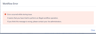

In a few projects, for selected issues on click of “Done” status following error is thrown:
Kindly suggest.

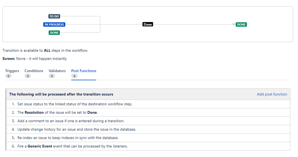

Are there any custom validators or postfunctions in the Done transition?

Please refer to the below screenshot for your reference.

at org.ofbiz.core.entity.GenericValue.store(GenericValue.java:118)
at com.atlassian.jira.issue.IssueImpl.store(IssueImpl.java:1217)
... 270 more

Looking at the log together with your post function above I cannot see anything that looks strange to me.
My next step would be to run the integrity checker and see if that could find any inconsistency issues
https://confluence.atlassian.com/adminjiraserver/using-the-database-integrity-checker-938847667.html
