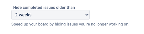

Kanban boards with automatically hide the issues that are in the right-most column when they have not been updated for a specified period of time. You can configure that period of time by going to the Board Settings > General screen, scrolling nearly to the bottom, and adjusting the "Hide completed issues older than" setting.

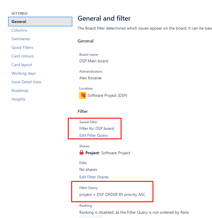

@Tanja Porre every kanban board has a filter otherwise it wouldn't be able to show anything. If you are a kanban board admin, then go to the three dots (upper right corner), click it and the then choose board settings.
Under "General" you will see the filter. Kindly paste here what it's written and that no "updated" JQL was used in this filter:
