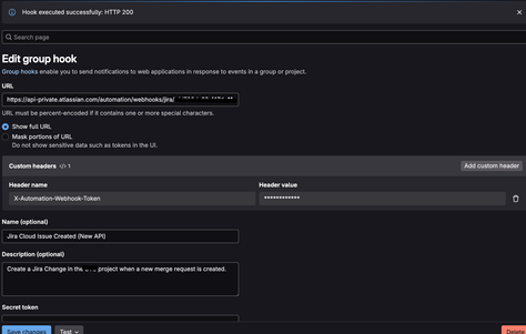

The URL change coming in May has got us to update or webhook rules in GitLab in preparation. Now that they have a new URL and secret token the gitlab tests are failing with an HTTP 400. I've used curl and can successfully hit the API and can confirm it in the automation audit logs. A 400 error is generic and I'm having troubles figuring this out on my own.
Is there additional GitLab configurations now needed for for the web hooks? Mostly just need merge request to trigger my Jira automations.
A custom header is needed in the GitLab web hook:

I'm using the same secret for both API URL's. This is the output from gitlab:
Hook executed successfully but returned HTTP 400 {"errorMessage":null,"message":null,"warningMessages":[],"errorMessages":["Missing token"],"errors":{},"status":400}
