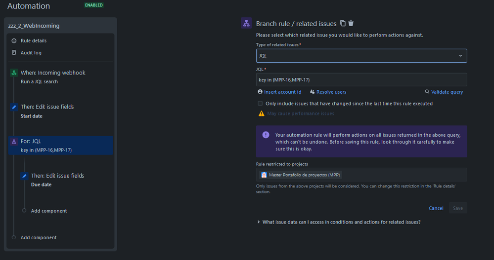

I have an Incoming webhook executed with "Issues provided by running the following JQL search" option. Definition JQL: "key = MPP-16"
We update start date on this issue in a first component edit issue, MPP-16 edited okay!
Then, execute the branch FOR: JQL "key in (MPP-16,MPP-17)"
And edit duedate in both issues, on MPP-17 this work, but on MPP-16 not.
Can someone tell me why?
Screens:

NOTE:
The fields used are just an example to show the problem, they are not the real business problem.

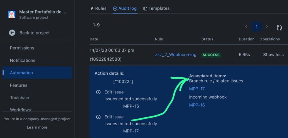

Does the Automation rule's log show any clue?
Marcos Milanesio
July 15, 2023
Hi @Jehan Bhathena
This is the log:
Jehan Bhathena

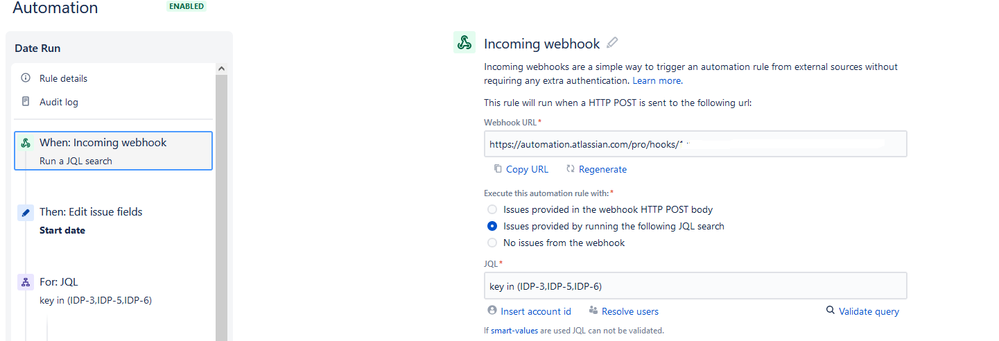

I created a similar rule at my end, and turns out I face the same behavior.
In order to work around it, I kept the JQL for the incoming webhook, and the Branch condition to be the same :
I did not find any documentation that mentions this exclusion or vague behavior, but I did find a few old community posts that MIGHT point to the same thing :
