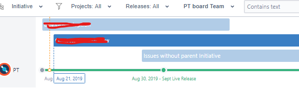

I am attempting to use Jira Portfolio for managing our larger initiatives but can not get Epics or Initiatives start dates to work. Scheduled Start date looks locked down and Target Date, which is set to Jan 2020 for the second Initiative isn't being recognized. I changed the view to be by Target Date and that didn't work. I also changed the earliest start date to Jan 2020 and no dice. The Initiative doesn't have anything open beneath it other than an Epic and all are set to "backlog" status.
Any advice on how to get this to work?

Getting an unestimated issue to show up on the schedule should work if you set up target dates and view the Target schedule. An unestimated issue will be scheduled when it has either a sprint, a release, or targets dates assigned to it.
Additional details on Scheduling unestimated items can be seen in the "Scheduling" documentation particularly the child pages:
One thing that is really common setting that can trigger this kind of behavior is if you have a release on the issues where the release date is set to a "Fixed Release Date" in the past and the release would be used to schedule the issue and as it is set to release in the past the issue is ignored and will not scheduled on the next setting which is target dates as the two values contradict each other.
Additionally when an issue is not showing up on the schedule it can come down to one or more of the data points not lining up with the plan settings, and there are several items that could be a contributing factor, the following is a list of items to start looking at to locate the conflict point:
