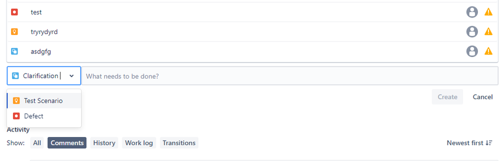

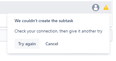

Why do I encounter two different types of inline sub-task issue creation. One that
(1) does not work for me and has error "We couldn't create the subtask".
(2) works fine as there is a popup window to allow proper input
How do I configure my project to use only option (2) method?

For example, this is how normally test scenario sub-tasks are created in my environment.
Once I typed in the Summary and click Create this popup Window appears and I can input the rest of the information and save.

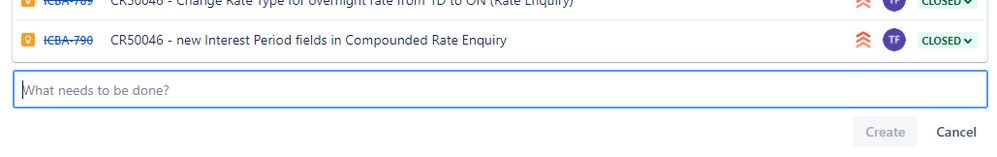

But I have created another set of schemes with new sub-tasks which resulted in
But this time the detail input popup window does not appear and the Jira is unable to create the sub-task with below error.

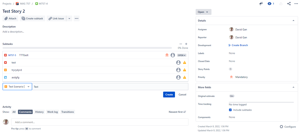

Hi @Stefan Salzl ,
Here is how the whole issue looks like. I have created an entirely new set of screen, workflow and issue type schemes and adopted the Light Weight Test Case Manager workflow from marketplace. I then associate these to a new project.
The Test Scenario is a sub-task that I should be creating under Story. There is no validator that I am aware of.

I have finally found the cause of the issue. It is due to create issue permission not given. But the Jira error could have been clearer.
Anyway much thanks for your assistance. Appreciate it.
