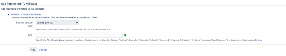

Hi @G_ Langevin, if you are validating it during a workflow transition you can use the out of the box "Asset Validator".

If you are talking about the validator with a regular expression? This can only validate the format of a field. But you cannot do logic with multiple fields.
Hi @G_ Langevin, I was talking about the regular Asset validator, on my end I can use AQL to verify multiples attributes. Are you also validating multiple Asset fields?
Based of field_1 value, the Field2 must have a value and not be null. If another value, field3 must have a value.
This may work. Did you do something like this?

I did not. I would usually use it to do a simple check for assets on a custom field during a workflow transition. Now having more information regarding your requirement I'm not sure if the "Asset Validator" would be enough or the best way of going about it. I hope you find a solution.
