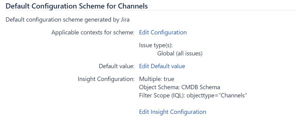

I would recommend you to check the settings of your custom field - contexts and default value. Administration -> Issue -> Custom fields -> Your custom field -> Actions column -> Configurate
Would you please share a screenshot from this location?

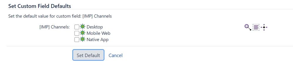

The most common case is the context of the custom field is not limited and there's a default value set, which results in the situation, where all the new created issues have this field set up, even though the field in not present on the screen.

On this field, context was global and for all project. However, we didn't set default value.
It's look like linked to the global configuration.

Hi @Mickaël Orsolino ,
thank you. The field is global, but the default value is not set, so the custom field is probably not set during creation.
I recommend you to limit the context of the custom field, but still we need to find out, why there are so many connections.

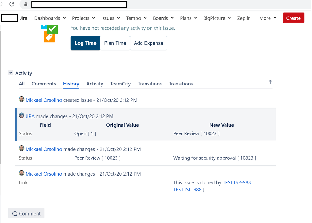

HI @Hana Kučerová ,
It's very weird because I don't see anything on the history/Activty tab on each ticket.
Its an example of impacted ticket on a test project:
For the concerned field, I have only two screen associated:
On this case, the field is still global. I think it's only linked to the context.

Thank you. Hmmm... this really indicates, that these issues are created with this value.
