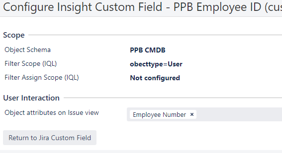

My user field is an insight object custom field with:
objecttype = User
And then I have an insight readonly field that I am trying to pull the Employee ID field from the previous chosen user, not sure what I am supposed to put in her to link it to the other field:
Does the Employee ID need to be it's own object in the CMDB for me to reference this? Or can anyone advise how I can do this? Thanks.

I don't think there is a way to create a custom field that is *just* an insight object attribute. If you want to display the employee ID as a separate custom field, you'll need to add Employee ID as a totally separate custom field, each employee ID would need to be a separate Insight object.
