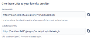

The plugin itself provides me this two links to give them to identity provider (pic is from the Jira plugin).
The first link i assume that i have put it correctly (pic is from Keycloak / Client section)
  • But what about the second one

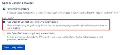

Except this, when i use this link which is provided from the plugin,2020-01-31 10_53_15-SSO 2.0 - Jiratest.png
  1. It redirects me to the keycloak login page (as i assume is correct) ,
  2. I provide the credentials from a user ,who exists both in Jira and Keycloak with the same name:password combination.
  3. After this, it redirects me back to Jira without being logged in , while i receive this error message.2020-01-31 10_58_34-We had trouble logging you in. - Jiratest.png
