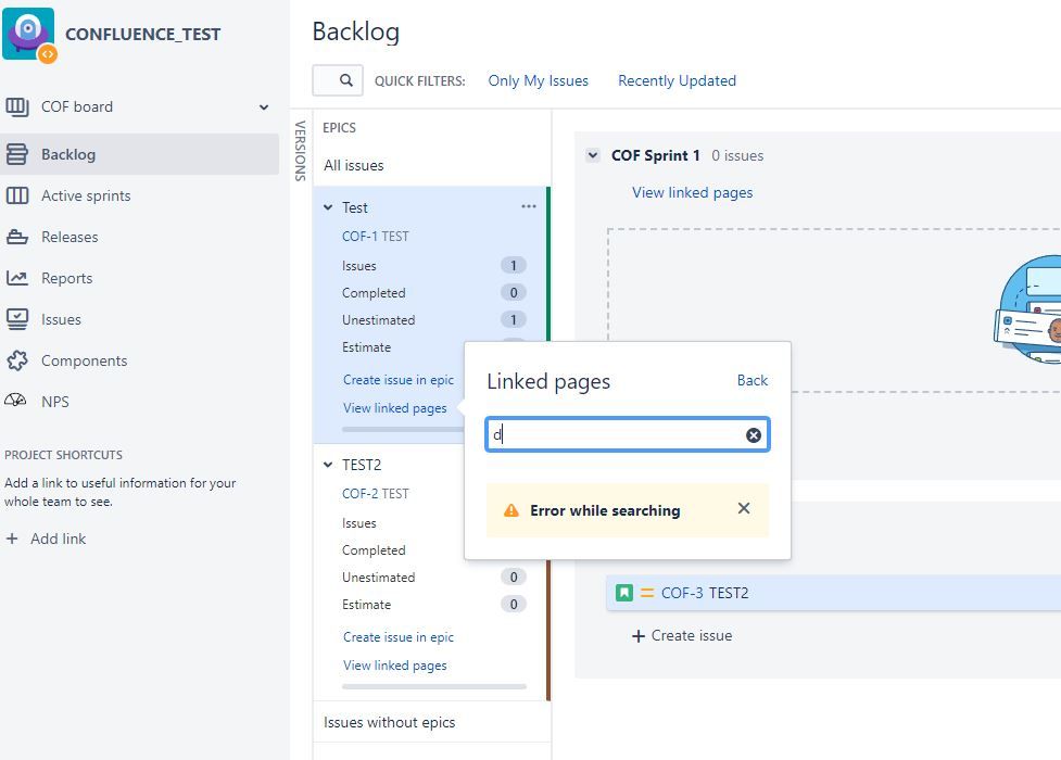

I think I managed to set Application Tunnel and link Jira and Confluence through it but I still have a problem with accessing Confluence pages from fro example backlog of my project:

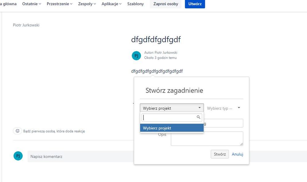

Same problem with accessing Jira projects from Confluence:
Do I need to make other actions to fully connect it?
