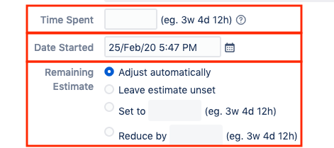

This has plagued me for quite some time, and I've struggled to find an answer. I know using Behaviours you can modify the system Time Tracking fields, however there is very little information regarding interacting with the Log Work fields.
I'd like to interact with each of these sections in log work independently using  behaviours:
Steven Mustari
February 25, 2020
After some experimenting (more testing is required) I've figured out how to interact with them some. Below is what I've tested and seems to work. I'll update this answer as more is discovered on this topic. If anyone has anything to add please share!
Remaining Estimate:
getFieldById("log-work-adjust-estimate-auto").setHidden(true)
Date Started:
getFieldById("log-work-date-logged-date-picker").setHidden(true)
