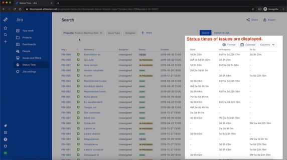

Mehmet A _Bloompeak_
April 5, 2020
You can use Status Time app. It generates status time report based on your working calendar.
If you are looking for a free app, you can try the free version, Status Time Free.

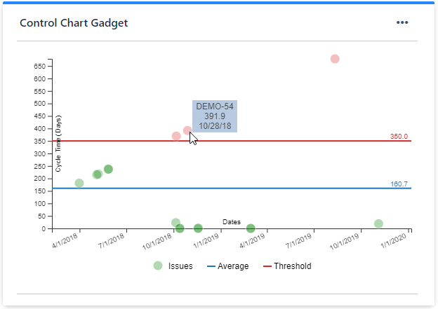

Danut M _StonikByte_
January 12, 2020
Hi @Oleksandr Lozinskyi
Try also our app Great Gadgets for Jira Server or Great Gadgets for Jira Cloud.
One of the 10 dashboard gadgets included is the Control Chart gadget, which is based on a Jira filter and is fully customizable. You can decide what issue are considered, by adjusting the filter's query.
See https://bitbucket.org/StonikByte/great-gadgets-add-on/wiki/Home#!control-chart-gadget
Danut
