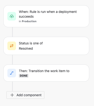

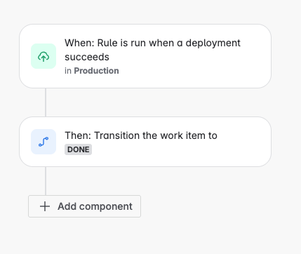

As you can see once a ticket has been deployed to Production it does not change status, and this is what I would like to achieve: change the status of all tickets that have been deployed to Production from `Resolved` to `Done`.
Is it possible?
Although the above worked, it also failed. I don't really understand why, but the tickets where correctly transitioned and I also had a rule failure (for the same tickets).
What I did to fix it was to only transition tickets that were in the Resolved status

I was looking more for something in Jira. I thought I would be able to use an automation, and I have tried (and still trying) but with no success. I can't figure out which trigger to use.
Do you have an example of your automation? Like a screenshot?
I might be able to suggest something.

I fell a bit stupid now, because I think I've got it (although I haven't tested it yet).
I don't know why I couldn't find that trigger before
