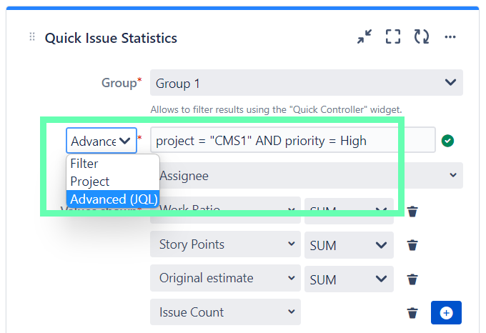

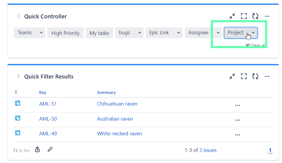

If you're looking for a dashboard which can be filtered dynamically per project by clicking on a button or a dropdown, you can check out our Jira cloud app Quick Filters for Jira Dashboards.
Our app comes with a set of standard gadgets, including the Quick Controller gadget. You can define dynamic filters per project on the Quick Controller, which filters all other Quick gadgets on your dashboard.
You can test the basic functionality of our app on our demo dashboards.

It depends which filter you use in your dashboard gadgets. If you use a "favorite filter" you would have to create a new favorite filter and associate it with the gadget on the copied board.
When you configure your gadgets with a JQL, you can edit the JQL in gadget of the copied board, without any effect on the original board.
Please note that filtering with JQL is a Quick Filters for Jira Dashboards feature. The Jira standard gadgets usually can't be filtered with JQL as far as I know.
