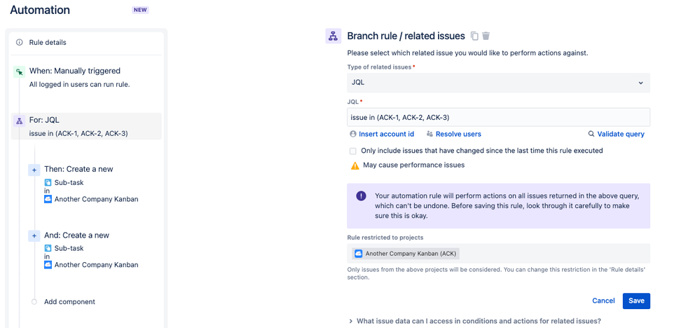

Hello @Hussain Ali

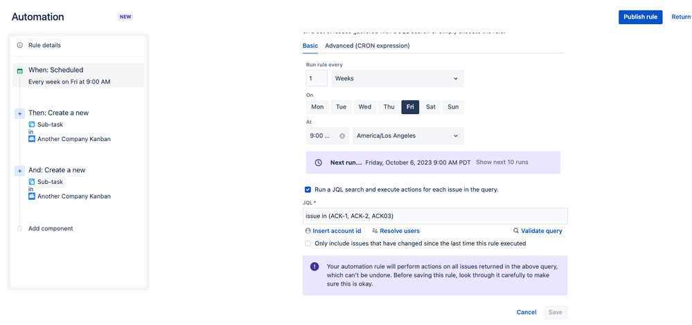

Do you have a list of the issues that need the subtasks? You could use a simple JQL with a comma separated list of those issues' keys:
issue in (ABC-1, ABC-2, ABC-3)
After you publish the rule there will be a Run Now button at the top. You can click that to run the rule once, then disable it.
Make sure you uncheck the box below the JQL field.
You can do the same thing with a manually triggered rule and and For Each/Related Issues/JQL branch.
Then you go to one issue in the project and trigger the rule manually. After it runs, disable the rule.
You can choose as trigger the scheduled option then run the rule based on a JQL
Thanks Mohamed! Would you have happen to have an example? I have never used this method before and I am no JQL expert either
