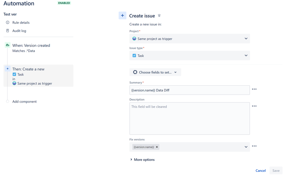

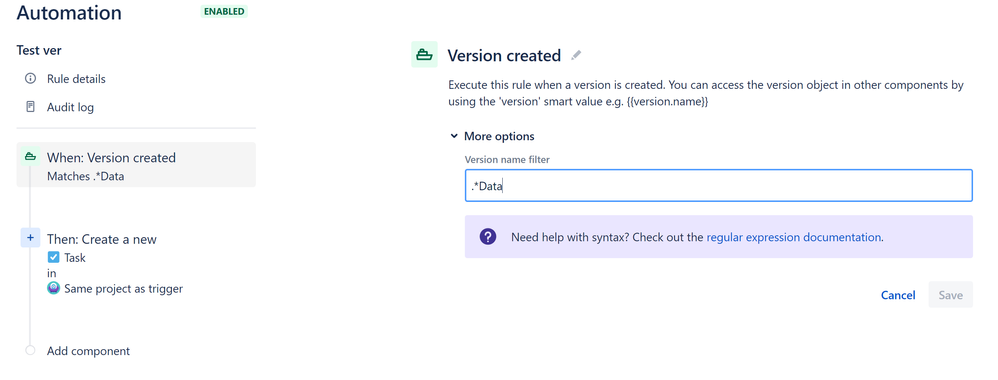

You can verify your condition in the Version Created trigger itself using regular expression. Check the following screenshots:
Also, remember that to set Fix Version you should use smart value. You cannot copy from the trigger issue because there is no issue that triggered that automation rule.
