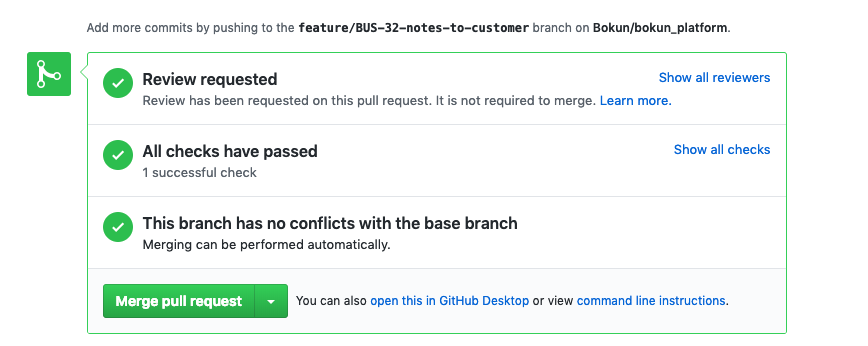

Is it possible to get a pull request checks in github based on JIRA ticket status
Sindri Traustason
March 18, 2019
Github can do various checks on a branch prior to merging. It would be very good to get the status of any associated JIRA tickets in that list.
6 answers
remi.debette
May 8, 2020 edited
I believe this is a crucial feature that would be beneficial to many teams.
Github is the place where developers go.
JIRA is the place where the business, issue creators and issue testers go.
In a clean process, an untested card should never be merged.
With the current JIRA - Github integration, developers can easily indicate that an issue is ready for retest, and also push a comment explaining how to do so (in the context of the CI for instance).
But the info that the test is done will currently live in JIRA : issue status change, or comment by the non technical creator/tester.
A check on the PR preventing the merge before the card has the right JIRA status would streamline the process for the dev or the Github Project manager and allow to cleanly define a good CI architecture.
