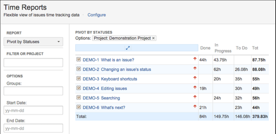

1 - You can use the Time reports app. This app provide you with the Time In Status Report that you can use to know the exact time you spent on each Status:
