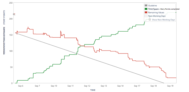

I have configured my board to Estimation statistic as 'Story point' and time tracking is set to "None".
I am expecting to see a greenline in my burndown chart indicating the story which has been completed and a red line to indicate the remaining story points.
Is it possible to achieve this? If so how?
Because currently I am not able to see a greenline in my burndown chart.
@Ste Wright and @Warren .
Thank you for your responses. I do not have burn-up chart configured in my project, hence my question is pertaining to the Burndown chart.
As Warren pointed out, when I am time timetracking I do get red adn green lines as per the below legend:
I am expecting something similar for story point, as in the picture below:
So that the final burndown chart looks like this:-
Hi @Julia Jose
Not how it works unfortunately - the burn-down for story points represents both added work (burns upwards) and completed work (burns downwards) - thus if you completed 5 points and added 5 points, it would be flat line.
Time Spent is a slightly different metric, in that it shows time spent not time completed - i.e the green line could exceed the top of the red, if you spend more time working than anticipated.
Ste

Hi @Julia Jose
It may help if you show us what you're seeing.
The burndown when you're tracking time does have a red and a green line
whereas for Story Points
so I'm not sure what you're expecting
Hi @Julia Jose
Not sure what you mean by two lines on a burndown chart - you might see this on a burn-up though?
These are two different types of report:
^ The burn-up does have a green line as well. Is this the report you're looking for?
The burn-up is available on Jira Cloud. It's not yet on Jira Server - see JSWSERVER-5513
