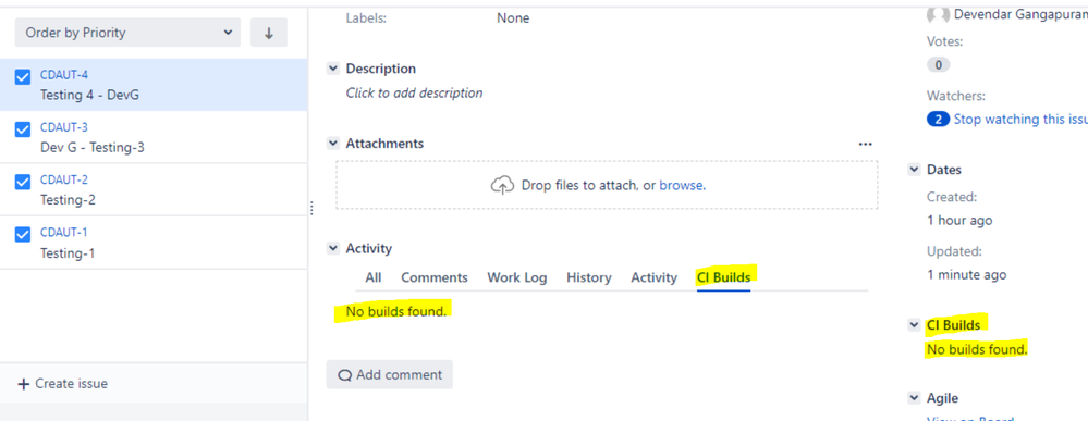

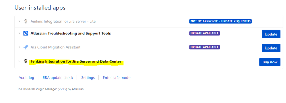

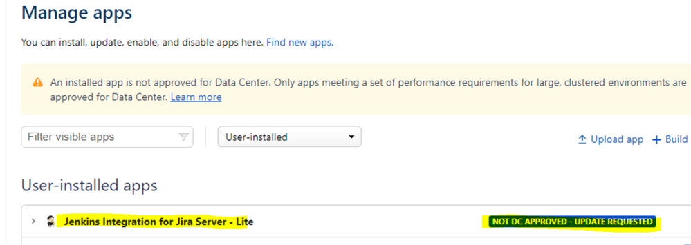

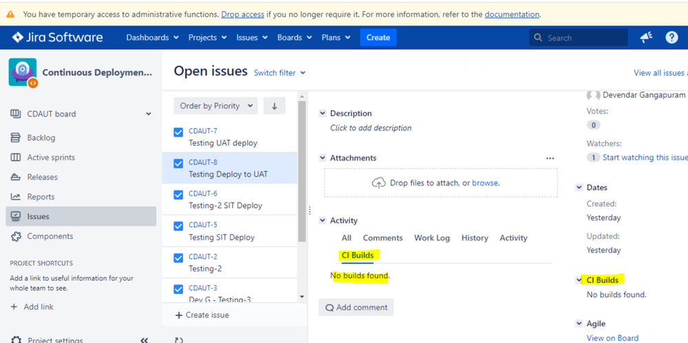

I have tried this app but it shows "No buils found" message on JIRA , though it had been executed a relevant build job on Jenkins.
Please let me know where this is messing up?
Note: I have still waiting for DC to be approved my update. Is this reason cuasing this issue?
Thank you.

probably you installed the wrong version using my fisrt link. Because you are on DC, you need to install a version compatible from https://marketplace.atlassian.com/apps/1211376/jenkins-integration-for-jira?hosting=datacenter&tab=versions
It should fix your issue.

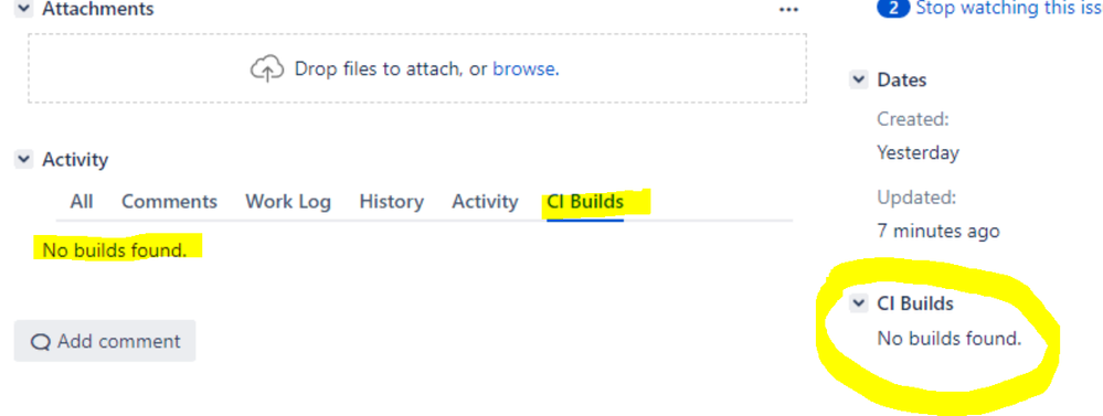

Thank you again @Fabio Racobaldo _Catworkx_ , but still no luck. it gives same msg : No Builds found.
CI Builds-Error-2.PNGCI Builds-No Founds.PNGCI Builds-Error-2.PNGCI Builds-No Founds.PNG
March 22, 2022

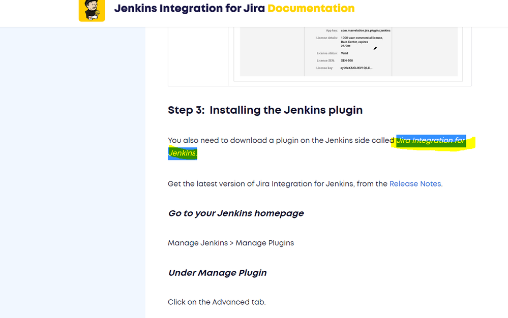

@Devendar Gangapuram , you need to install plugin also on jenkins side. Please take a look at the official doc in order to install and setup app correctly.
Please, unistall Jenkins Integration for Jira Server - Lite.

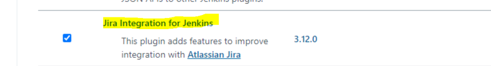

I could not find the "Jira Integration for Jenkins" plug-in , looks not available .
Please assist me asap.

Thank you so much once again @Fabio Racobaldo _Catworkx_ , I was very useful link that you have shared me. Unfortunatley, even after configured all the things as per the document there is no luck.
I have installed "Jira Integration for Jenkins" on JENKINS , but still no luck.

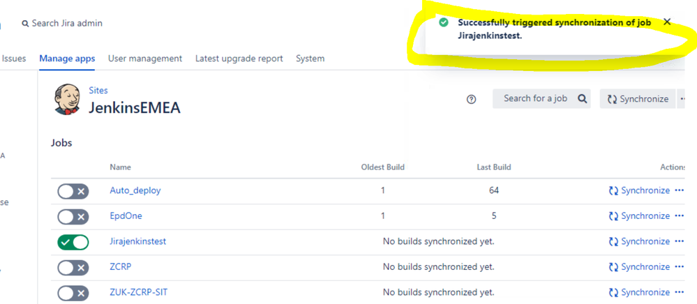

Devendar Gangapuram
March 24, 2022
Thank you once again,
I have followed already and it was showing syn succesfull.
Still shows "No Builds found" on JIRA CI-Builds section. Please check once.
March 24, 2022
Hi @Devendar Gangapuram ,
in order to have build information within a JIRA issue, you need to have a key of jira issue at build level.
Read here for further information :
Linking Builds to Issues
Jenkins builds are linked to Jira issues if a key of an existing Jira issue can be found in the job and build data that was synchronized.
The following elements are inspected to extract Jira issue keys:
  • Job display name
  • Job description
  • Job url
  • Build display name
  • Build description
  • Build trigger cause
  • Change-set commit messages
  • Git branch names
Any potential issue key located will be verified to exist, and a link between the build is issue is only created if the issue exists in Jira.
