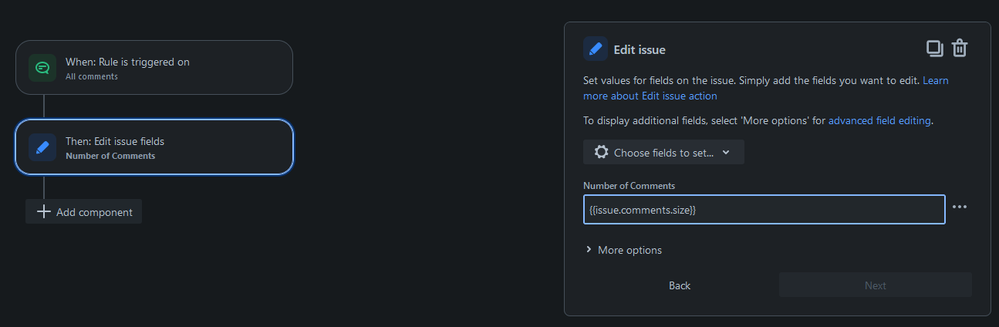

Something you can consider is using automation to calculate the number of comments and inserting them into a number field.
The steps in summary are as below:-
  1. Create a new custom field of type Number Field named Number of Comments
  2. Configure an automation to populate the Number of Comments custom field whenever a comment is added
  3. Add the newly created custom fields to your dashboards/filters
An example of the automation configuration is as below:-
You can also add in additional conditions for when a comment is deleted instead.
